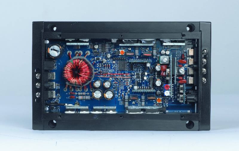

Laser veo que eres instalador, ¿conoces la marca dls?, hace tiempo los vi y me parecieron amplis interesantes, lo mas parecido que encontre a los antiguos orion.
Ultimate A2 - 450 Watt power amplifier
Bridge mode connections and more
Manual for Ultimate A2 - A7
Product Reviews
Test A2 in AutoHiFi 5-2004
ULTIMATE series A2 is a two-channel amplifier. Power output of 2 x 85 Watts with 4-ohm stereo and 290/450 Watts with 4/2-ohm mono bridge-connection.
The amplifier is 1 ohm stable.
- Built-in variable 50-125 Hz switchable low pass filter for subwoofers.
- Built-in/switchable variable 20-200 Hz high pass filter that can be used as a subsonic filter or high pass filter for front systems.
- RMS output power @ 13,8 V DC feed with max 0,1% distortion, 20 Hz - 20 kHz
This product is discontinued
The Ultimate series amplifiers are
known for the good sound quality with a detailed, high resolution
sound. The amplifiers are often used in SQ competitions in both IASCA
and EMMA competitions. The amplifiers are often used in cars winning
both European and World championsships.
Specifications
Number of channels2
Amplifier classAB
Mono bridge mode 2 ohm450 W RMS
Mono bridge mode 4 ohm290 W RMS
Output power in 1 ohm2 x 220 W RMS
Output power in 2 ohm2 x 145 W RMS
Output power in 4 ohm2 x 85 W RMS
Damping factor> 200
Input impedance, high levelN/A
S/N ratio, A-weighted> 100 dB
Low level outputNo
Frequency range10 Hz - 50 kHz
High level input with auto startNo
Input sensitivity0,2 - 7 V
Input impedance> 10 kohm
High pass filter20 - 200 Hz
Low pass filter50-125 Hz
Power consumption (idle)0,6 A
Power consumption (max)60 A
Rec. power cableMinimum 5AWG / 16 mm2
Fuses2 x 30 A
Dimension (W x D x H)265 x 240 x 73 mm (10,43 x 9,45 x 2,87 inch)
Weight3,7 kg ( 8,16 lb)

Sí, la marca DLS es muy buena, es considerada marca Premium en muchas artes del mundo. Sus productos son altamente recomendables
